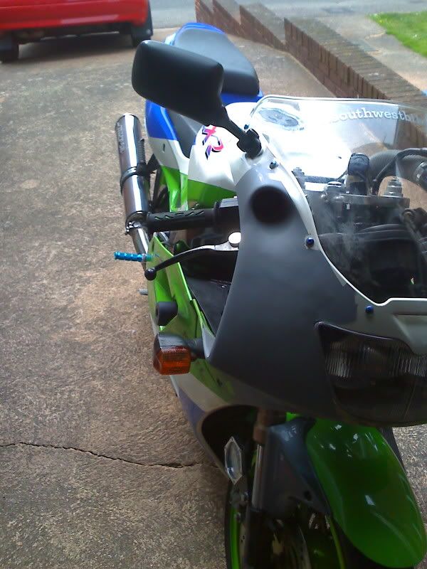

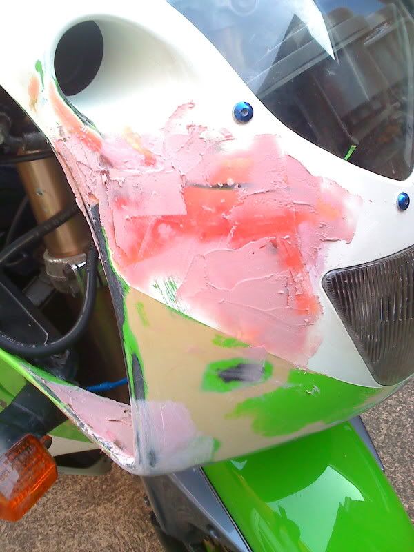

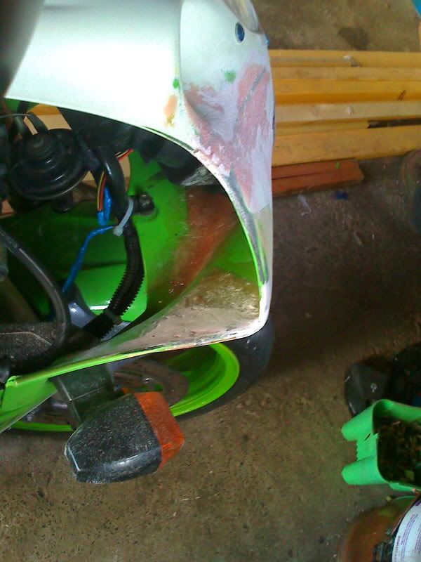

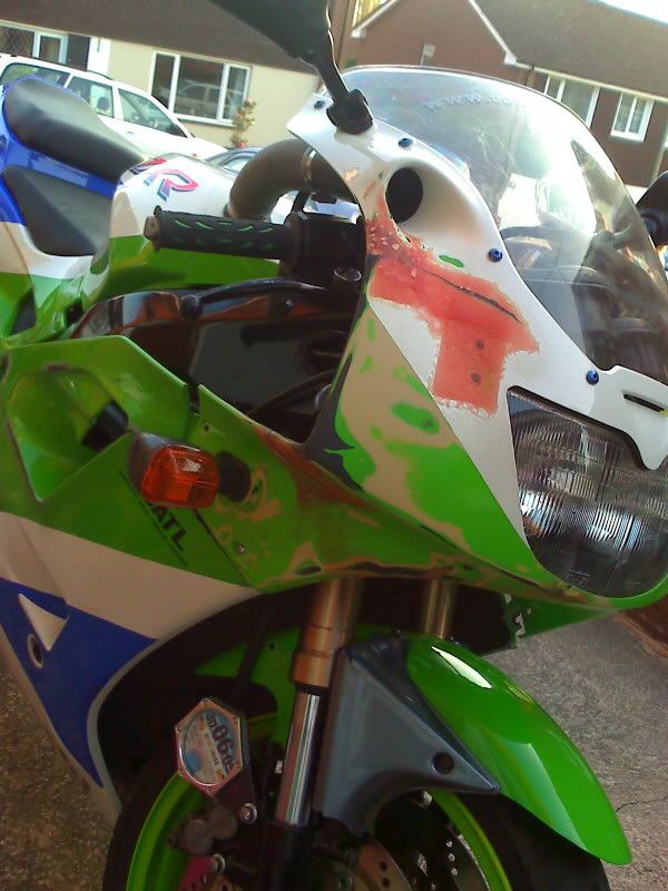

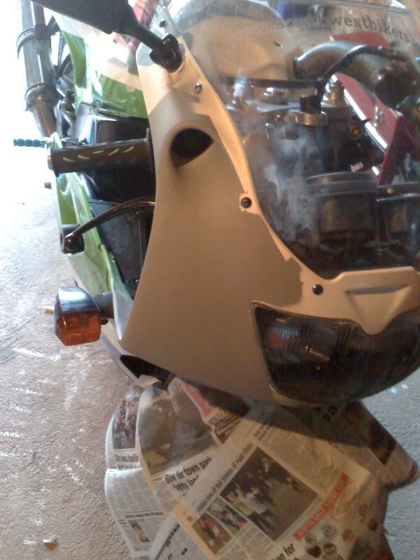

Hi, I'm very skint and trying to sort out the sh!t bodywork my new ZXR came with. Never done any proper spraying or fibre-glassing etc before so i'm gonna let a spray shop spray the bits for me.

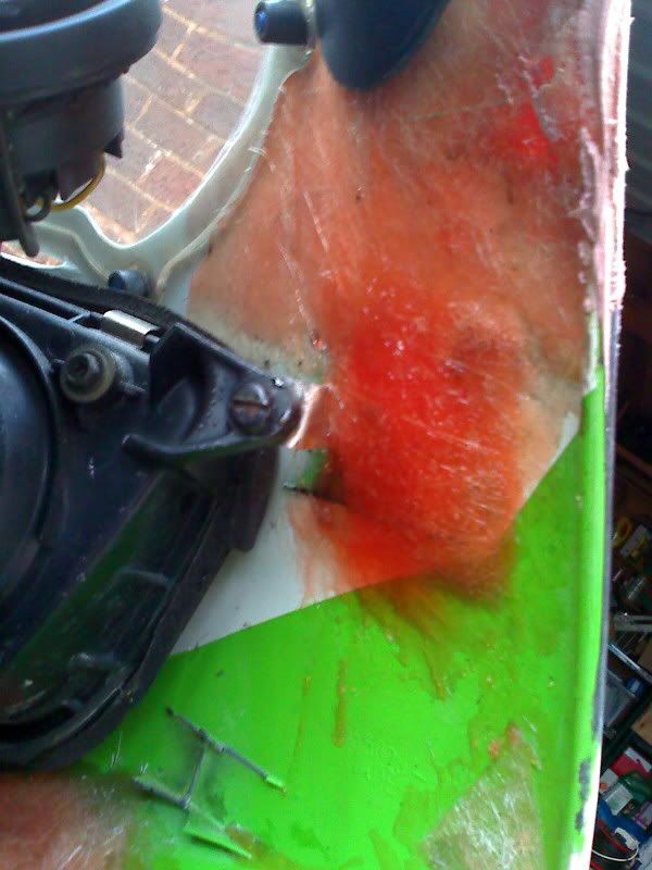

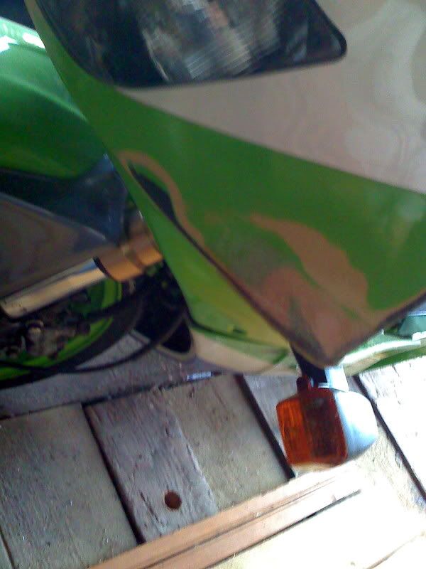

but.. i've fibre glassed and sanded down the dammaged areas.. still needs a bit more bodyfller to sort out the lumpy areas and a few more layers of primer..
does anyone know of a really cheap but good sprayer in exeter? will they mix the colours and gloss it there.. or do i need to get hold of the paint/gloss etc? will i have to take in the parts that need spraying or can i just give them the whole bike? how much do you think these bits will cost to get painted?... Thanks, Tom.

Not wanting to piss on your cornflakes, but the fibreglass repair you've done to the fairing will not last particularly long. Fibreglass does not adhere well to ABS fairing plastics and will come away. The only way to get a good permanent repair of fairings is to have them plastic welded properly, any cracking should have a small hole drilled at the closed end to stop them spreading further. Try and find someone with the correct kit to do the job, or buy the Wurth ABS plastic repair system and do it yourself for a couple of hundred quid. I have the Wurth system and the ABS rod system, and out of the two the Wurth system is far superior. I've successfully repaired far worse panels than yours, very little is past saving with the right kit and some time.
ock
Posts: 80
Joined: Oct 5th, '07, 21:29
Location: penzance, cornwall
Re: Spraying & Bodywork help??..
Post by ock »
sorry dude but I would have to agree with Jam, I`m a panelbeater so I do it for a living, what you do with cracks is weld them up with a soldering iron then a small amount of filler just to make where you welded flat, you don`t need loads of fibre glass or filler as plastic doesn`t really dent, and if it has you use a hot air gun to push it back out, next you need a plastic primer and then I would use a 2k primer to stop it all moving underneath, might be easyer if you got a good second hand one of fleabay and let the painters prep and paint it, at least if it looks sh*te its up to them to put right :wink:
