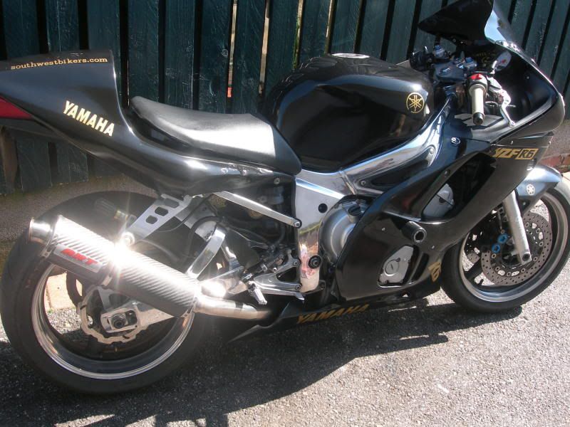

As long as your patient enough you can get a decentish finish, obviously you will never get it as good as the original paint but it can be acceptable.
I sprayed a spare set of panels I had with rattle cans and they turned out ok, not brilliant. Note the wonky decals and on the seat unit where I got bored of sanding :mrgreen:
Oh and wipe any petrol off instantly or it will melt your paint off.

steve-d wrote:As long as your patient enough you can get a decentish finish, obviously you will never get it as good as the original paint but it can be acceptable.
dudde that looks awsome! are you restricted?.. how much is insurance on that?
